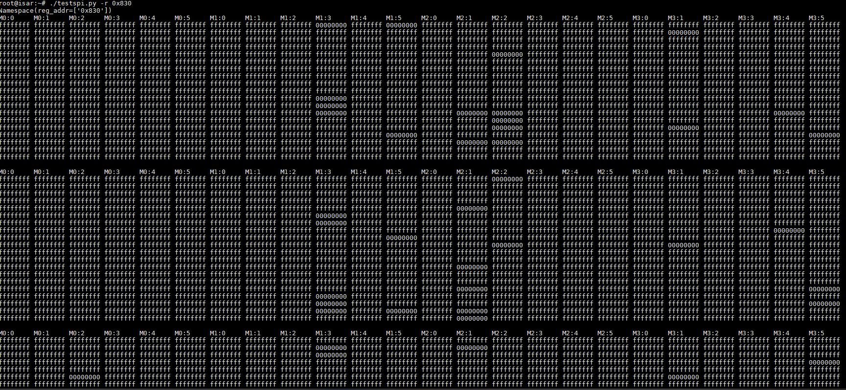

We have designed the TCAN4550 into our product. We have 24 TCAN channels in total. The schematic for all TCAN chips is identical.
Around 8 of the 24 TCAN chips are experiencing a weird SPI issue. Attempting to read SPI registers higher than 0xff sometimes returns 0x0. Accessing lower-address registers (ex: 0x0, 0x4, basically anything under 0x100) works reliably over a long period of time.
Every TCAN chip is located close to its level shifter. We have also tried inserting 500R SPI series termination to a channel which is malfunctioning with no improvement.
One can see here that reading 0x4 is reliable with no issues for all channels:
Reading 0x1000 is problematic for some TCANs:
Channel M0:2 is actually the channel with improved signal integrity (500R series term). SPI Signals have around 1V overshoot/undershoot with VIO = 5V. Not the greatest but definately no where near threshold levels.
The puzzling questions is: What is the difference between reading 0x1000 and 0x0004? Both bit patterns have just one bit set in the address part of the SPI read command. I can only explain this behaviour with something internal to the TCAN. All channels have identical software and SPI implementation.
Just to increase the confusion, I have noticed that the register 0xC behaves differently for the channels which are malfunctioning. Healthy channels read out 0x28000008 while unhealthy channels sometimes read out 0x28000000. This means "Internal_access_active" not being set. I cannot explain this further however.

  • Reading out 0x4:
    Reading out 0x830 (0xffffffff is expected):
  • read 0x4 (all OK):
    read 0x830 (0xffffffff is expected):
    read 0x1000:
  • Hussein,
    Thank you for all of this information upfront, the images in your first post didn't come through so if you could re-send those that would help. This sounds like a clocking problem due to the registers you are able to read consistently vs. the ones you are not able to read. All registers in the 0x1000 or 0x0800 range require the internal oscillator to be working to enable the digital core and allow those registers to be accessed. All of the 0x000x registers are hardcoded into the TCAN4550-Q1 and can be read without a reliable clock.
    Is it possible to monitor the OSC1 and OSC2 pins when you're having issues to see if they aren't reliable? And can you share a schematic of your board? If it is sensitive information, you can click on my username to find my email and email me directly.
  • Hi Eric,
    Thank you for the valuable input. It pointed me in the right direction.
    I replaced the XTAL Oscillator caps with more suitable values and the 40MHz sine wave is now between 1V and 2V (it was previously 0.25V to 1.25V). Guess what? It works!
    Thank you for your fast response.
