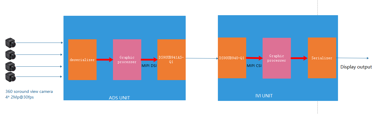

I want to use DS90UB941AS-Q1 as display serializer in my system.   Is it possible to just use DS90UB941AS-Q1  MIPI DSI1 port as video stream input from SOC?  Is there any limitation for my solution?
I checked the Datasheet of DS90UB941AS-Q1, it seems I just need configure DSI_PORT_SEL in BRIDGE_CTL Register Field to select whitch port I want to use.
