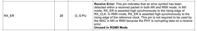

My customer is having trouble that DP83822I does not start up in the right mode.
According to the datasheet, it should be starting up in auto-negotiation and auto-MDIX mode. The internal PU/PD resistors are defined this way.
The PHY is connected 1:1 to the MII of the AM4372B and no additional configuration-resistors are used.
Problem is, the PHY often starts in FD mode and then does not recognize a standard 10/100M LAN cable.
Have you seen this behavior before? Any hints on how to address this issue?
We have also found this note in the data sheet:
Shall the RX_ER now be connected, or not? It is not exactly clear from the data sheet paragraph. In my customer's design, it is connected.
Thanks, in advance for your help
Josef
  • Hi Josef,
    PHY link-up mode ( FD or Auto-Neg) is strap configurable. Can you please read and share the SOR register 0x467 and 0x468 ?
    Geet
