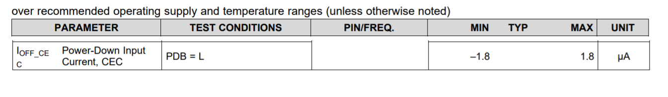

DS90UH949 datasheet mentioned the CEC pin power down input current  is within +/- 1.8uA.
But when we power off (remove the power supply) the DS90UH949 and connect the CEC pin to a 3.6V power supply via 27K ohm resistor. we saw >10 uA leakage current.
may i clarify the test condition of below spec. When doing below measurement, are supply voltage provided to DS90UH949, or there is no supply voltage ?
Any idea why the leakage current become so big > 10uA when there is no power supply to DS90UH949 ? and any workaround suggestion ?
