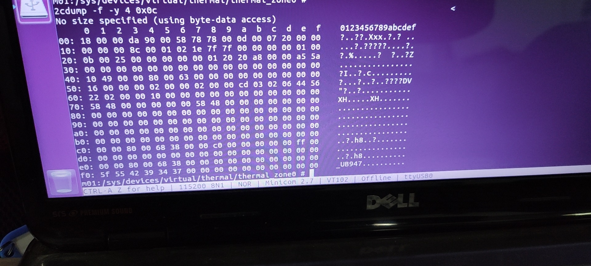

    also, you can dump the reg. to check if the reg. can be downloaded correclty.
    Steven
  • Hi Stevn,
    we can confirm that it related with tem ramping.
    In a stable temperature, 947 can work properly. Now, customer refer to ERRATA, 947 can operate at -40C to 70C in cold-start condition and 80C to -30C in hot-start condition. their desired opertation is -40 to 80C.

    and, they can dump the reg correctly. below is dumped reg is
  • If your customer can pass -40 ~ 70 temp. ramping up  test but failed at -40 ~ 85 temp. ramping test, you need focus on if the below setting in RED is correct.
    you can try 0x87 to replace 0x88, if it can pass the test?
