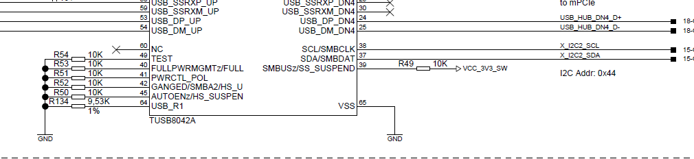

Hallo,
can someone explain that to me? Why pull-down resitors at an open-drain net?
Kind regards
Holger Schwär
  • Hello Holger,
    Can you reattach the pictures?  I can't tell which pins you are talking about?
    JMMN
  • Hello JMMN,
    I´m talking about Pin 38 and 37.
    Kind regard
    Holger

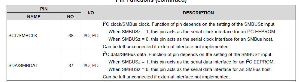

  • Hi Holger,
    The internal pull-up / pulldowns on the configuration pins of the hub are only enabled during the sampling period after power on reset. The pulldowns on SDA/SCL help the hub to determine if an EEPROM is connected or not.
    JMMN
  • Hallo JMMN,
    the problem is the pull-downs are still active after reset. But the hub works fine. Maybe a config problem? I want to access TUSB8042A via I2C were TUSB8042A is the slave.
  • Ah, you are correct these devices leave the SDA/SCL pulldowns enabled after power on reset, the other configuration pins are released.  To use the I2C interface you will need strong external pullups, 1K-2K.  If you want to access the hub as a I2C device from an I2C host, SMBUSz should be pulled low.  Please be aware that the hub will not connect as a hub in SMBUS mode until the I2C host has set the cfgactive bit in the hub register to exit configuration mode.
    JMMN
