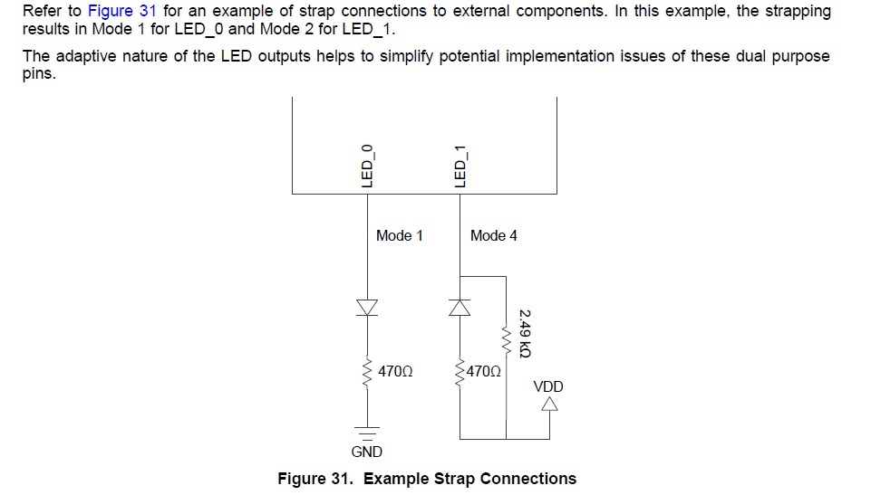

Hello, I have a question about page 47 of the datasheet. I don't see how LED_0 could be in MODE 1 or LED_1 be in MODE 4? Is that a typo?

Hello Joe,
LED_0 information is correct, but looks like led_2 has a mismatch between figure and text. I will double check with team and get back.
Vikram
Hello, thank you for responding to my post. LED_x are only 2-level strapping pins.
