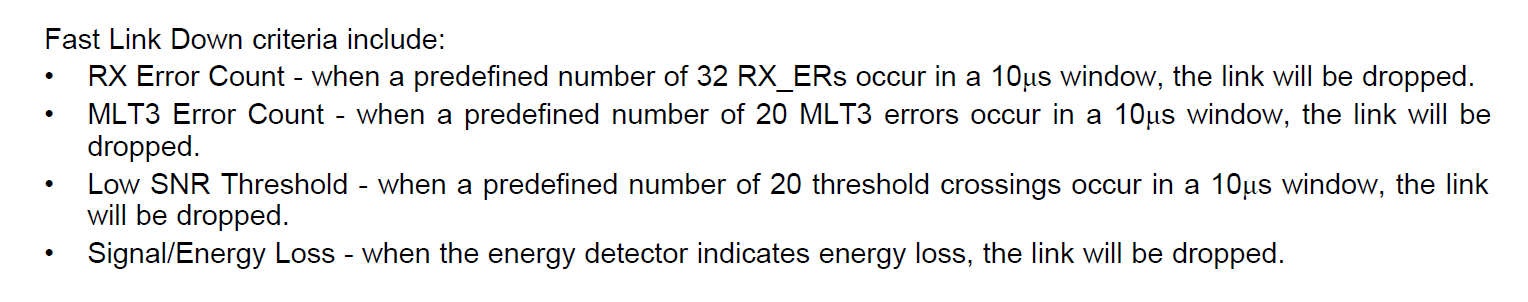

Could you please check the Fast Link Down criteria. One of the criteria shows Signal / Energy loss in datasheet. I guess it is for drop power or line of link partner, and it should be normal matter. Please let me know if there is special feature for FLD.
Will the link be keep when bit 0 of 0x000b is disabled even if the line is drop?
Will the link be drop after 10us when the line drop when bit 0 of 0x000b is enabled? (Datasheet doesn't show the 10us window in Signal/Energy loss sentence.)

  • Hello Nagata-san,
    When Fast-link-drop is enabled, PHY can be selected to look for loss of energy (energy below a threshold) in 4us window and it drops the link if energy is lower than threshold in this window. For normal case, PHY will look for energy lower than threshold in 32us and drop the link if energy is low in that window.
    As mentioned in the data-sheet, other than usual criteria of low energy PHY can be programmed to drop link for criteria of Rx errors, MLT3 errors etc.

  • Hello Nagata-san,
    If link-partner will disappear, link will also disappear. By default fast link down is disabled.
    Case 1 : Enabling FLD :  FLD feature check the line voltage threshold in 4us.
    Case 2 : Disabling FLD(default) :  Instead of 4us, it looks at 32us window for the energy from link-partner.
