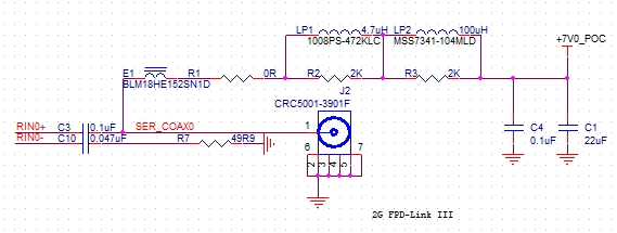

below is POC circuit, we would like to know which parameters should be consider besides the inductor value. for exampel the DC resistance and Self-resonant Frequency. could you give some suggestions. thanks.

Hi Betty,
I believe I provided an app note to you via email regarding PoC consideration. The two most important things to consider are the current rating and the forward and back channel.
What's the pairing deserializer? Will it be running in sync or non-sync mode? What's the max current?
