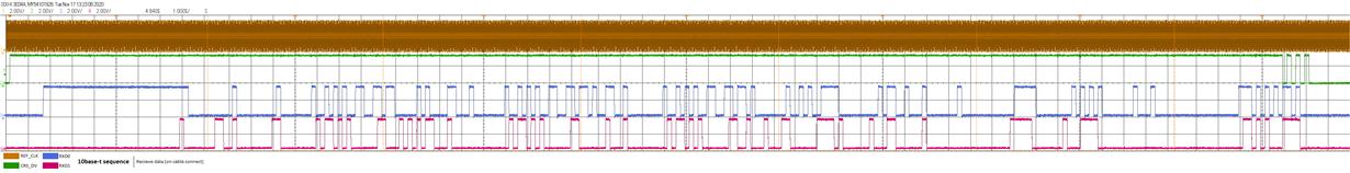

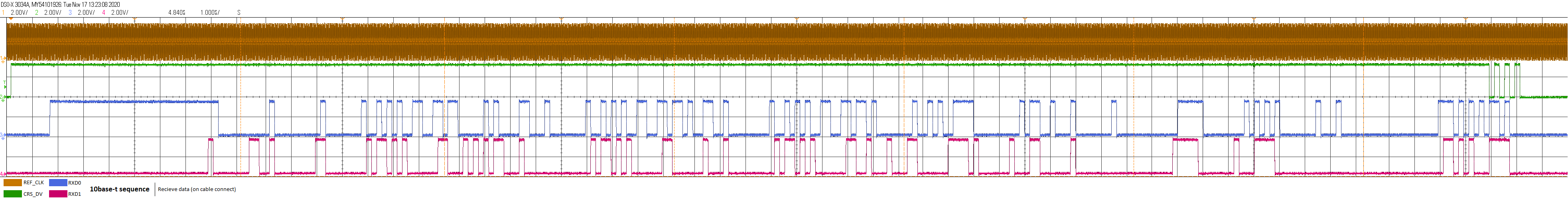

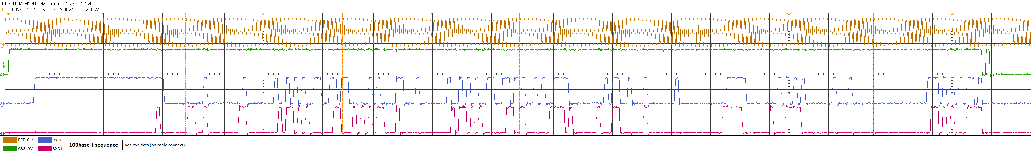

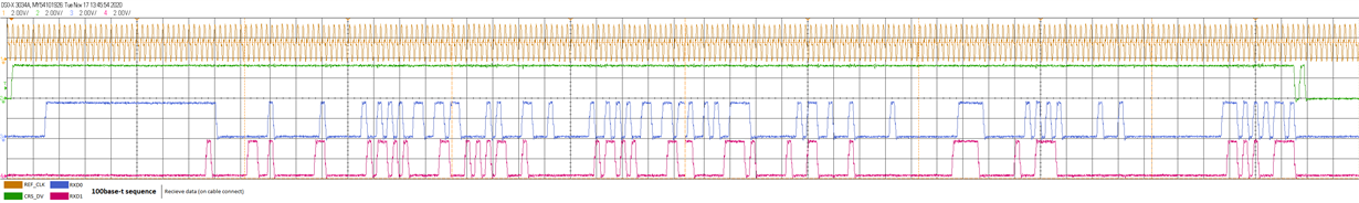

  • An update,
    Can confirm that data is transmitted from the phy to the MAC in both 100Mbps and 10Mbps.
    When a connection is negotiated I see data transmitted (presumably a LLDP Multicast packet). Output seen in the scope output below:
    100Mbps
    10Mbps
    On 100Mbps valid data is detected, at 10Mbps dont get any valid data. When I take a look at the Ethernet Statistics (CPSW_STATS Register on the AM3356) Then I see that he RX_ALIGN_ERRORS and RX_JABBERS are incremented (which is not the case on 100Mbps).
