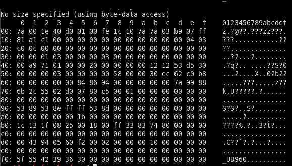

I've succeeded to generate test pattern on the hub and display it on the connected display, but I can't get image from cameras to display on screen. The following hub registers are indicating possible errors with input stream synchronization:
- FWD_STS (0x22): 0x00
- CSI_STS (0x35): Periodically shifts between 0x00 and 0x01
- CSI_TX_ISR (0x37): 0x0F after trying to stream image with gstreamer. On subsequent reads it shows 0x03

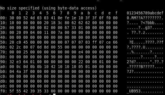

As advised by First Sensor support I've checked LINE_COUNT and LINE_LEN registers (0x73 - 0x76) to see if the image data from serializer is arriving correctly to hub and it does. We've checked CSI lanes between hub and SoM with oscilloscope and the lines we're constant at ~1.2V
The deserializer is configured for synchronous forwarding with line concatenation and 400 Mbps CSI-2 serial transmitter speed. The OV10640 imagers are configured to output RAW 12 image format with 1280x720 resolution at 30 FPS and the serializers are configured for DVP mode. Below I've also attached i2c dumps of the hub and one of the serializer after trying to stream with gstreamer.
Serializer:
Deserializer:
