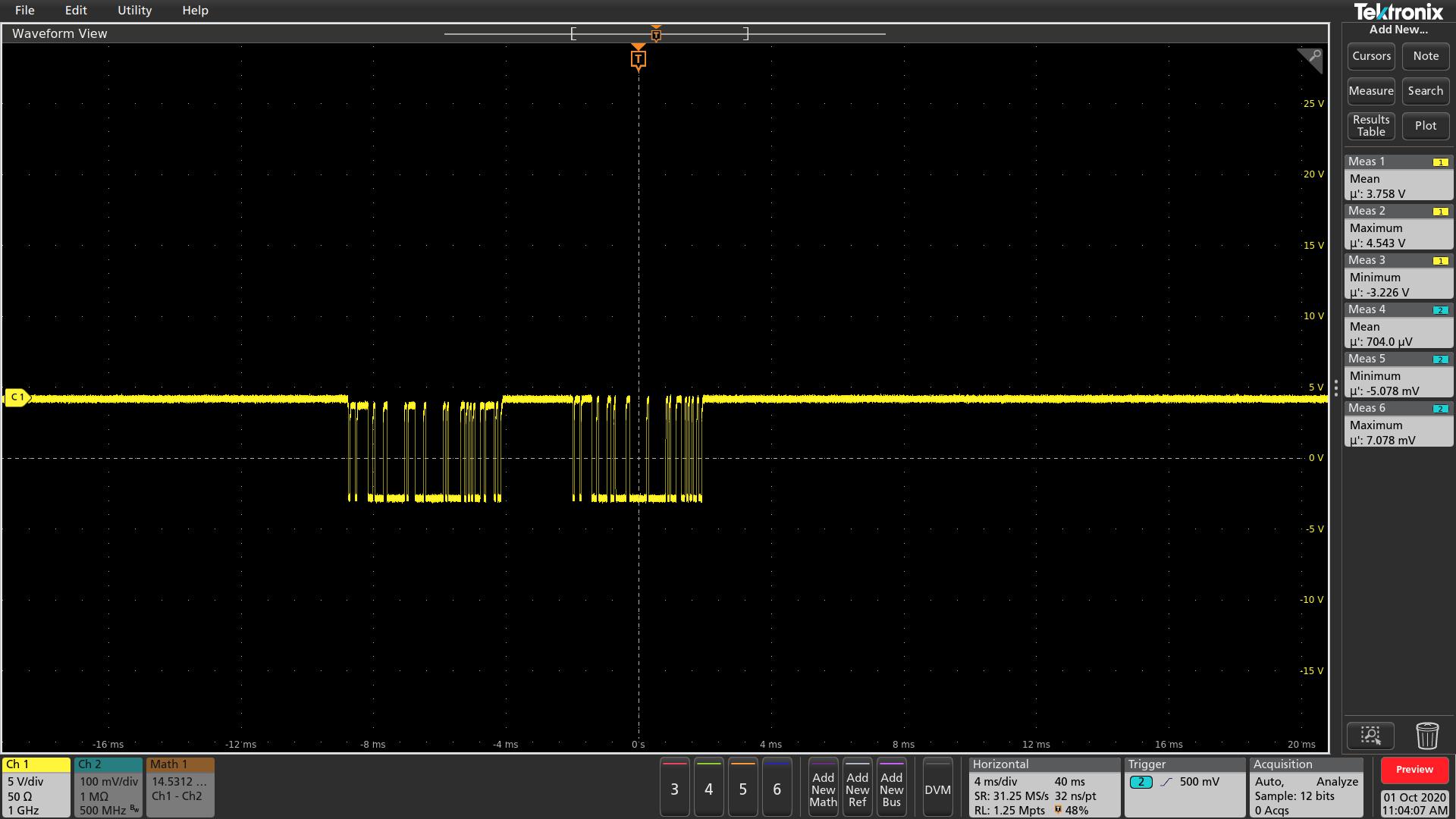

Some of the scope captures are measured with the differential probe.

    Thanks for your input. Since we don't have common ground in our system between the Fan, VFD & the Control Board. I have tested A & B w.r.t respective grounds of the components and got below data. Test has been repeated on three Units to confirm.
    Common Mode Voltage Measurement
    A & B had same resistor value of 10k. This A & B is common bus between the Fan, VFD & Control Board.
    Measurement was performed with Oscilloscope between Resistor common terminal & w.r.t respective Ground of respective component.

     Additional Notes:
    1. During the test no high amplitude noise was observed. Some noise was picked up by long ground wire, but was minimal within above mentioned limits.
    2. Tested with system running and ideal, voltage did not change.
    3. Unit 1 was only brand new unit. Unit 2 & Unit 3 has passed through lot of HDVP test, DLS & Biotron.
    4. Meter reading matched the oscilloscope.
    5. Fan Transceiver P/N: SN65HVD72D, VFD Transceiver P/N: ISL83080EIBZ-T, Control Board Transceiver P/N: SN65HVD10
    6. All these above Transceiver are capable of operating between -7V to 12V.
    Please help to provide your inputs.

  • Aditya,
    Thanks for you detailed measurement. Since little noise was observed and the results are consistent between the multimeter and scope, I think they're reliable. It looks like it's safe to running the system without shared ground.
    Hao
