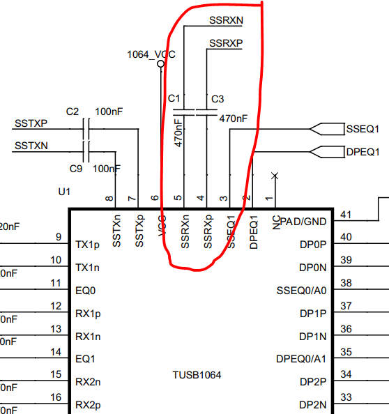

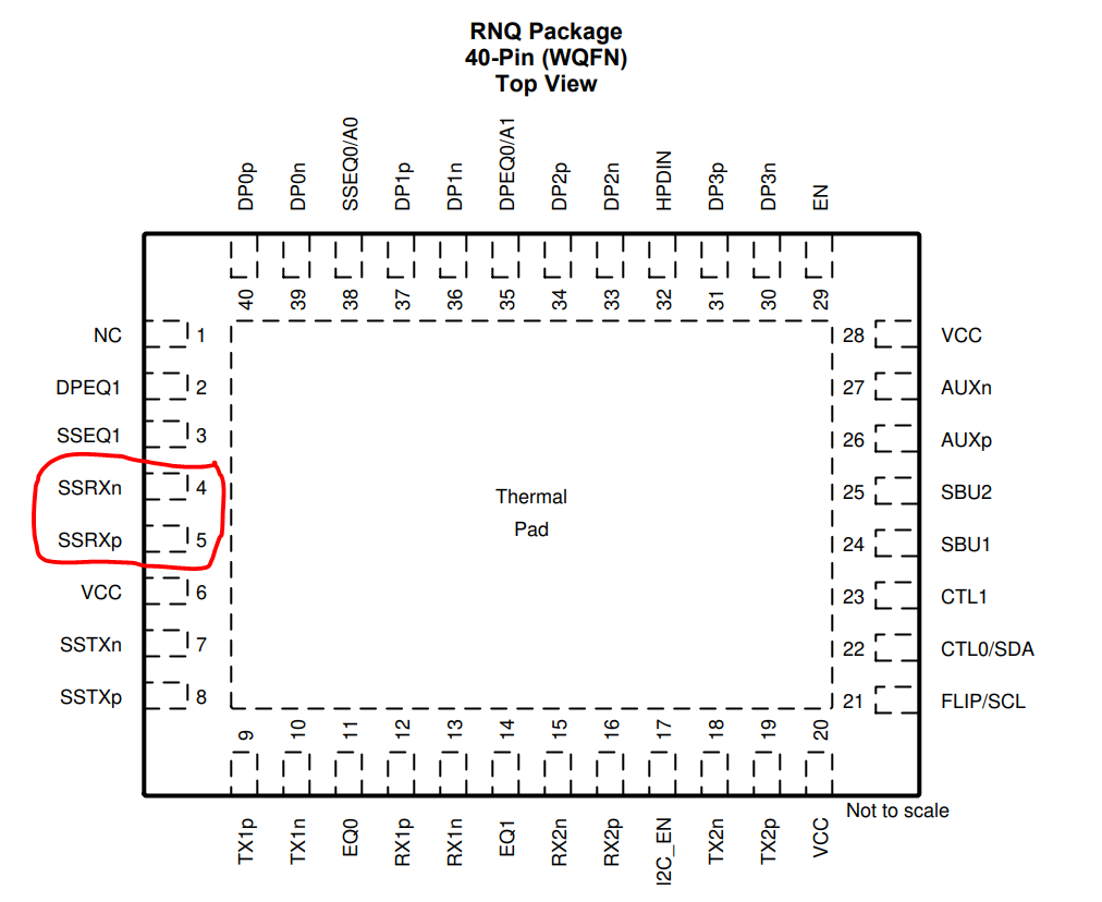

Part Number: TUSB1064
The Datasheet and EVM have conflicting info on the pinout of the SSRXp/n pins, can you tell me which is correct?

Please follow the datasheet. Since USB3 supports polarity swapping, this is a don't care.
