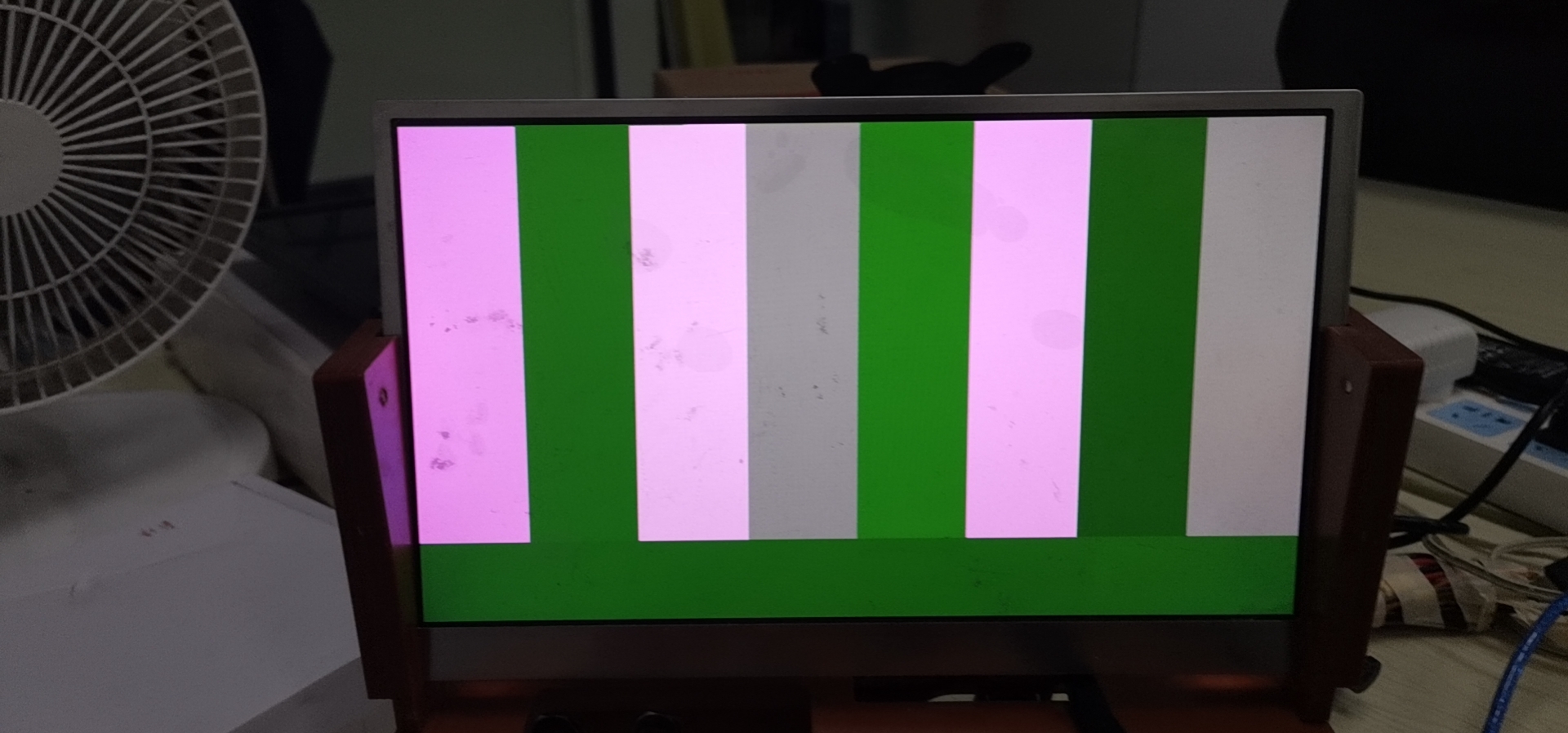

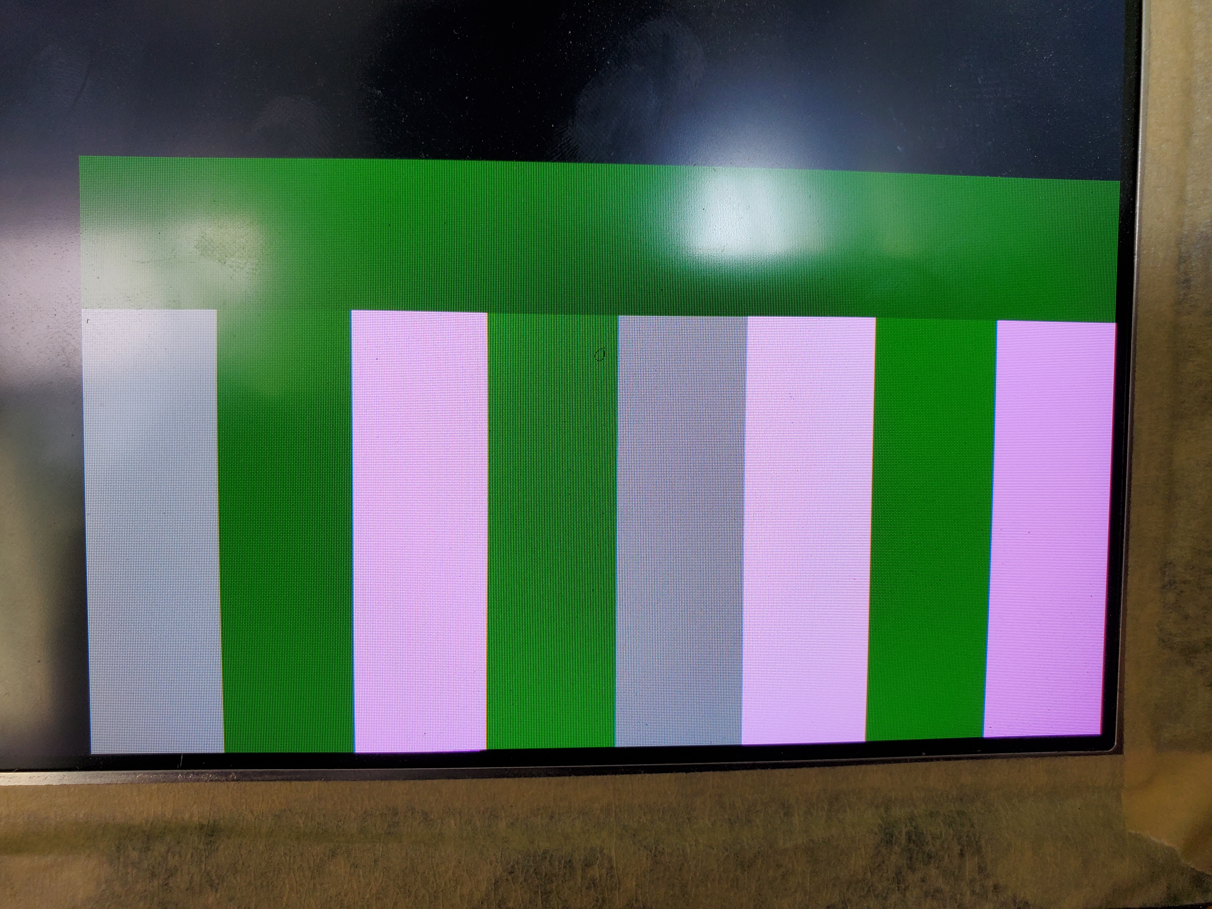

Now I am checking customer's urgent issue.
Customer now use T7+ 964 and 933 to do 360 surrounding view.
They have made 600 pces board, and 20 of them can't display normally as the following picture shows. Moreover, this kind of flickering phenomenon occurs as soon as the power is turned on, and cannot be restored by restarting, and it can be reproduced 100%.
PCLK:99MHz       960p*25 fps         YUV422 8 bit
I asked customer to enable 964's PATTERN GENERATION.
The normal board:
The abnormal board:
Here are two questions I would like to check:
1. It seems the abnormal and normal board have the same color bar. Could it prove 964+T7 have no problem? The problem is on the camera module 933?
2.Is the color bar ok? Why the color is so strange?
 Based on the PATTERN result, I think the problem is on the camera module. but I really doubt whether my judgement is right. because the color bar is strange...
