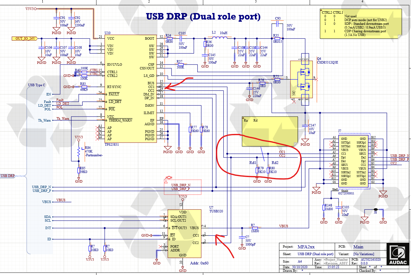

We have a CPU with a USB2 OTG port.
Now we are going to connect this port with a USB type C connector.
The USB C acts as the host and device.
In host mode, we need to supply a voltage of 5V with a current from 1 to 1.5A on the device.
In device mode, the 5V from the external host is not used to power them.
See attached file for more details.
I use a TPS25831 to power the device.
We use the TUSB320 to automatically switch from host to device.
The CC1 and CC2 pins are used on both components.
Can we use these pins in parallel?
How should we configure the CTRL1 and CTRL2 pins?
Must the pins DM_IN and DP_IN of the USB C connector also connected to the tps25831?
If there is any other comment with the drawings you can always let me know.
