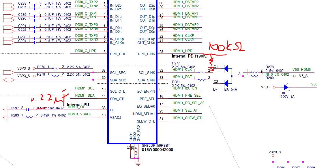

Hi team,
We found that OE pin is unstable that cause HDMI mal-function.

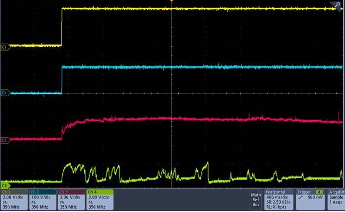

We've check the time sequence that OE pin is raised 100us after Vcc.
Could you please help to check what may cause this problem?
Thank you.
Ch1: V3P3_S ; Ch2: V1P1_S ; Ch3 : HDMI1_OE ; Ch4 : HDMI2_OE
