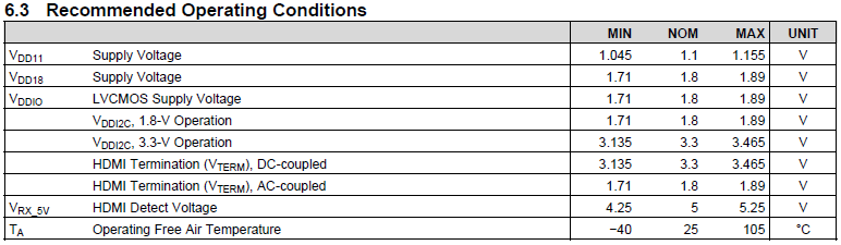

Hi there,
For our application, most of the signalling is done at 3.3V levels. Can we pull the INTB (pin 13), REM_INTB (pin 40) and HPD (pin 42) open-drain outputs up to 3.3V directly? The datasheet recommends 1.8V, 1.8V and 5.0V respectively.
Chris
