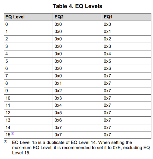

In register 0xD3, bits[5:0] provide a value the Adaptive EQ status..
How are bits[5:0] split to generate the EQ1 and EQ2 values below?

Hello Jared,
0xD3[5:3] = EQ2
0xD3[2:0] = EQ1
