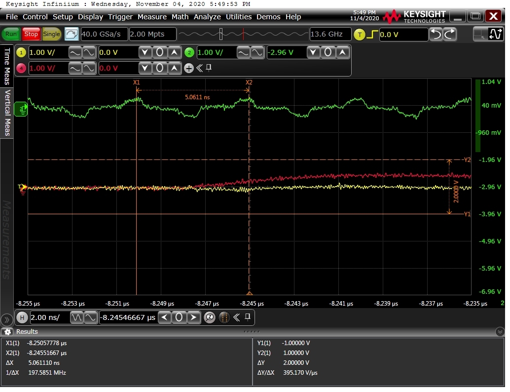

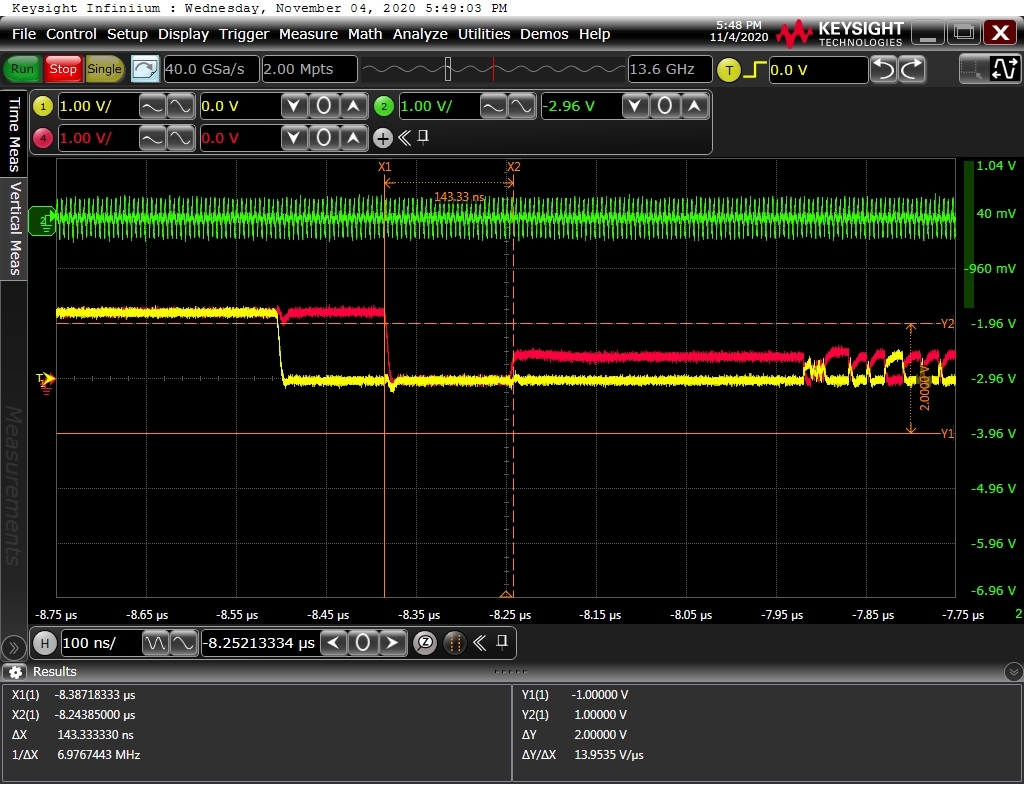

customer test UB965, and the SOC can't reveive the MIPI signal. customer capture the output of 954 find the MIPI time is doesn't match d/s
in datasheet, the T_HS_PREPARE is 40+4ul ~85+6ul, actually, customer measure the T_HS_PREPARE IS 133ns, below is waveform.
we need your help on below items:
1. how to adjust the MIPI signal time to match the d/s. if can't adjust, why the T_HS is longer than d/s
2. does the T_HS_PREPARE can affect SOC to reveive signal?
3. could you give guiance to debug? thanks.
CLK: green
Red--DP(CSI D3P) ; Yellow--DN(CSI D3N)
