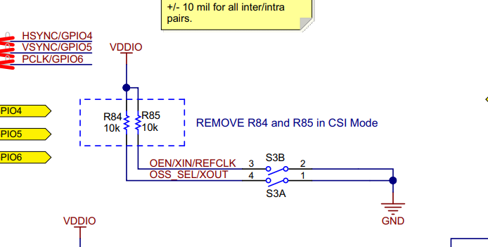

Part Number: DS90UB934-Q1
Hi Team,
The datasheet said OSS-SEL need to less than 4.3k, but the EVM is 10k?
Could PIN 34be floating instead of 4.7uF to GND?

Hello Amelie,
about OSS_SEL, it looks like it is a typo in the EVM. The Pull-up resistor is not mandatory, but if you decide to use one, then it should be =< 4.3Kohm.
No, you can't leave VDD11_FPD floating. It requires a 4.7uF or greater capacitor to GND.
