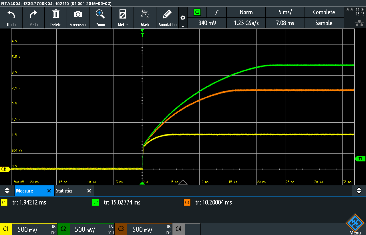

According to your Two Supply Sequence Figure 115 and Table 101 in Chapter 11.1 I have noticed that there is a Minimum requirement for the ramp up time of 0.5ms.
Things are working fine, but when I measured the supply ramp times I have these kind of ramp times (see picture below)
I have a really fast ramp time (~200us) up to ~700mV, then a slow ramp time until reaching stady state.
Do you think this will cause any issues with the DP83869? Especially with the 1.1V (VDDA1V1) supply?
