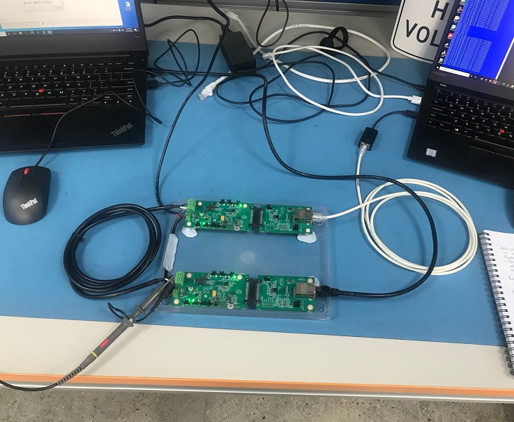

We recently purchased two DP83TD510E-EVM boards for evaluation in hope to migrate our Ethernet products over SPE.
We would like to connect 2 x EVM boards via SPE and communicate with a laptop at each end of the RJ45 connectors and run a Jperf speed/network test
Have run through the Board Setup process in the User Guide.
  • External 12V DC Supply connected to J12, total I ~ 0.08A for 2 boards.
  • Measured all onboard supply rails are fine.
  • We have set both our boards, following User Guide Section 3.2.1 to RMII Master Mode for DP83TD510 providing 50Mhz Clock to DP83822 (Slave) via R149 (PCB Factory Default)
  • LED_0 is strapped low at J20 on both of the EVM boards.
  • SPE link cable 1m twisted pair

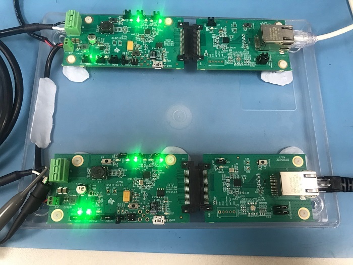

The following is our image details our setup:
We have also downloaded the USB2MDIO Tool to downloaded one scripts at a time that we discovered via the forum post, with no success in linking between boards A & B.

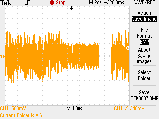

On the SPE board we see LED_1 illuminate on power up, LED_0 only turns on occasionally for what seems to be a few seconds before it drops off again. (See Image below)

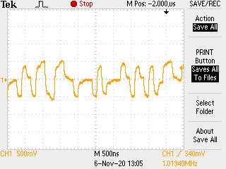

Below is a zoomed out CRO snapshot of the SPE pk-pk when there is a link LED_1 present for a few seconds before it drops off, and the pk-pk of this signal goes down to 1V, and then it continues to attempt again.
Note: Disregard the gap in the signal, due to shifting the screen cap horizontally.
Another zoomed in screen cap below, when there was no link LED_1 present:

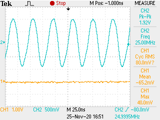

    In your setup, after removing USB cable do you just loose link or the power to the 510 device goes down? If you are supplying power through 12V DC source then removing USB cable should not power down the PHY. As a sanity check, can you confirm if the shunt connections match with section 3.1.1 of the user's guide. For 12V DC source, shunt J9 needs to be removed.
    To check that the 510 PHY is still on after you remove the USB cable, can you check the clock out pin to see if the output clock is available? You can also probe XI/XO for the same check.
    For the pdf schematics, I will get back to you shortly.
    -Regards
    Aniruddha
  • Hi Aniruddha,
    No power loss, only the SPE link is lost when USB cable is removed.

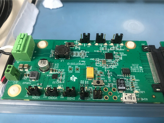

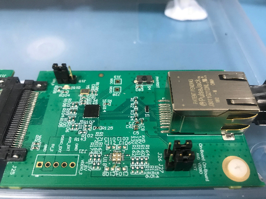

    Images below for shunt connections for 12V DC external power as detailed in section 3.1.1
    Clock is available when both SPE Link is Up and Down, see screen caps below;
    XI (25Mhz) - Board A & B
    XO (25Mhz) - Board A & B

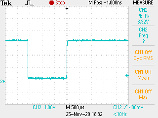

    Not sure if this could point to something, although I noticed a difference in Vpk-pk between boards is 900mV at RX_CLK-1 (50Mhz)
    When SPE Link is Up.
    Board A
    Board B
    To re-establish an SPE link as mentioned, I must re-connect USB and download Auto-Neg Script.
    It seems the SPE PHY registered are being RESET when I remove the USB cable.
    The 510E datasheet, and it states the following;
    Measuring the RESET pin at S3, whilst removing the USB cable the signal asserts itself low for 1.5ms. See screen cap below;
    This could explain why the Internal 510E PHY registers are being reset to default and requires the Auto-Neg script to be downloaded each time.
    Hope there is enough data here to determine why this could be occurring.
    Hope to hear from you soon, thanks.
    Daniel

  • Hi Daniel,
    Thanks for sending in the previous feedback. The RESET pin toggling low would definitely wipe out the register settings. It is weird that it happens during USB disconnect. The Reset pin of the PHY is connected to the on-board microcontroller through a level shifter. I am currently checking if there is anything in in the microcontroller or the level shifter that can cause this disconnect. As discussed before, please find the EVM schematics attached below.

  • Hi Aniruddha,
    Thanks for confirming the reset of the PHY registered is caused via the onboard MSP430 MCU, look forward to a fix on this.
    Appreciate you sending through the schematic also, controller ports and component designators are much more readable this will assist in following the signal paths through.
    Yes we caught up with our friends at Arrow Electronics today, and discussed the MAC controller with the FAEs, they will do some research and come back with a solution.
    I will send you a E2E private request, looking forward to discussing the upcoming PoDL solution with you also.
    Cheers,
    Daniel
  • Hi Daniel,
    We are still working on narrowing down the reason for this reset pulse. I will follow up once we get a resolution. For the PoDL, I will reply on the private chat.
    -Regards
    Aniruddha
