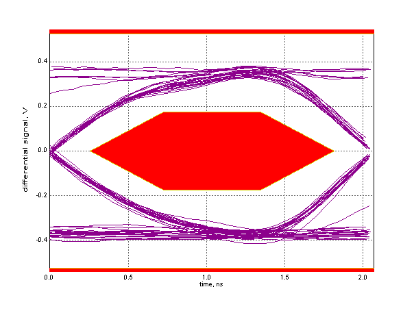

    Here are far end eye diagrams for this "downstream" 4m section of cable when this TUSB216 is in shutdown:
    PCBE side:
    PCBD side:
    Here are far end eye diagrams for this "downstream" 4m section of cable when this TUSB216 is in boost 3 mode:
    PCBE side:
    PCBD side:
