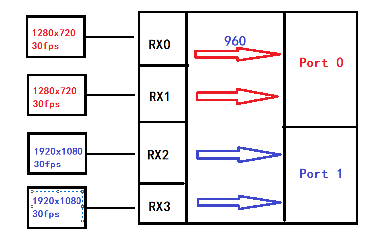

Recently,we are working on the DS90UB960.
I have two different   Camera resolution size  sensors
one type: 933 + isx019  1280x720@30fps
another: 953 + imx390   1920x1080@30fps.
The 960 document  description is as follows:
Q1 ----------What I want to use is below, Can I use it like this:
Q2---960 has two i2c interface,I only use one of them,When is the other i2c used   ?
BRs
thanks
  • Hello Yingjin,
    yes, this is a valid usecase! You just need to enable forwarding and map the correct RX port to the correct TX port, in register 0x20.

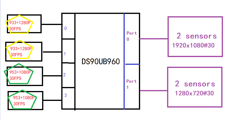

  • Hi Hamzeh
     I got it.
     I can configure  register 0x20 of 960 chip.Map the RX0 and RX1 to port 0, Map the RX2 and RX3 to the port1 as below:

  • Hi Hamzeh
    I got it.
    But I still have a little confused.
    For example, the first two ports are configured as 933, and the last two ports are written according to the configuration of 953。
    When I write the first port,I will  write 960's  0x58 reg  as 0x58.  When I write the last two ports, I will still operate the 0x58 register. In this way, the 0x58 register of 960 chip will be repeatedly written as 0x5e.
    In that case,the first two 933 Ser  sensor setting,   Is this  still OK  ?
    BRs
    thanks
  • Hello Yingjin,
    As I said, once you want to configure Port0 for 933 you write:
    0x4C = 0x01
    0x58=0x58 ... etc
    then configuring Port1 for 933, you write the same:
    0x4C = 0x12
    0x58=0x58 ... etc
    for configuring Port2 for 953, write
    0x4C = 0x24
    0x58=0x5E ... etc
    and then or configuring Port3 for 953, write
    0x4C = 0x38
    0x58=0x5E ... etc
