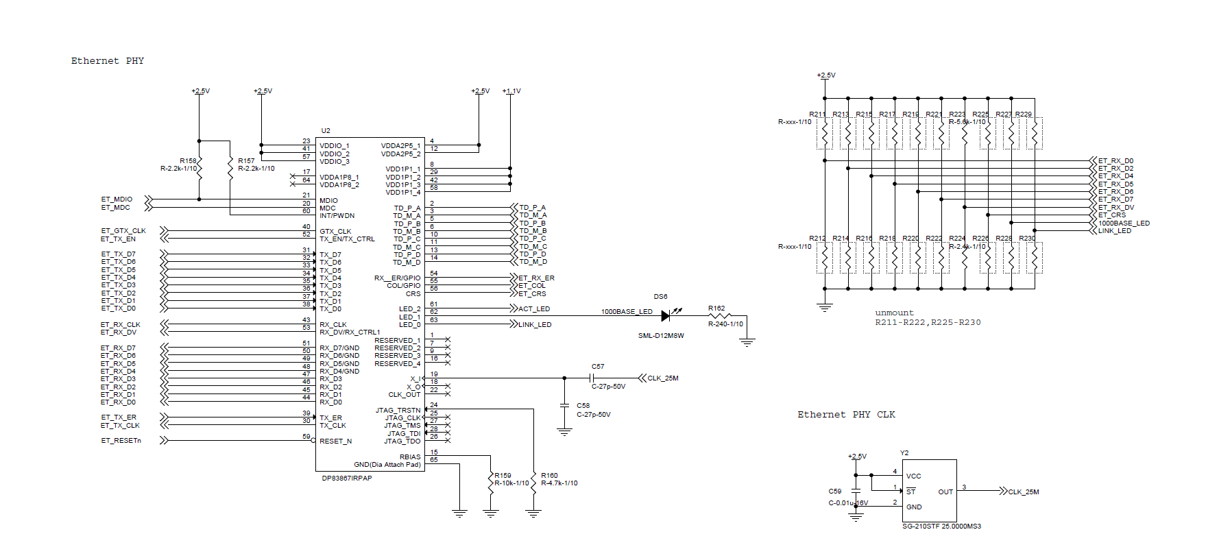

  • Dear Justin
    The strap pin is connected to a MAC device (Intel, MAX10) or LED.
    The pin that plays the role of GMII is connected to the MAX10 and is set to the tri-state when the PHY is powered on.
    The control pin of the LED is connected to GND via the LED and a resistor.
    Megumi
  • Hi Megumi,
    Can you please provide the schematic for this application?
    Justin
  • Dear Justin
    The circuit around the PHY is attached.
    Unfortunately, we cannot provide all the circuits.
    Megumi
  • Thank you Megumi,
    I will get back with information from our validation team in 1-2 days.
