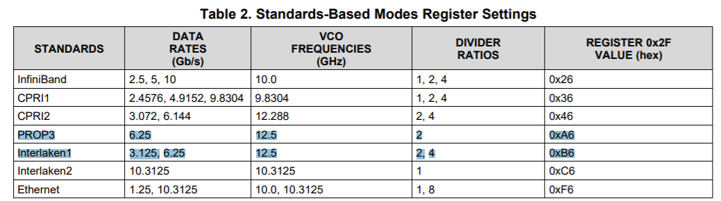

My application uses CoaXPress with DS125DF410.
The data rate is 6.25Gbps. Then if VCO frequency is the same such as 6.25Gbps and DIVIDER RATIONS sets "1", the CDR is not lock.
However VCO frequency is 12.5Gbps and DIVIDER RATION sets "2" such as PROP3 and interlaken1, then CDR is lock.
Do you know the reason why CDR doesn't lock when data rate and VCO frequency are the same?
