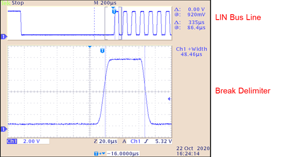

This is the issue generated during the LIN Conformal Test, when a new LIN Frame (Message) is sent, 1 bit (or more bits) is configured as Break Field (Break + Break Delimiter) at the beginning of the frame.
As a result of the test, Break Delimiter in Break field should be 1bit (or more bits) – 52.08 usec, but it is measured at 0.93 bit – 48.46 usec.

    Is it possible to share waveforms of this occurring? It would be good to capture TXD, LIN and RXD on the same screenshot. I want to see if there's any skewing from TXD to LIN to RXD.

    Waveforms capturing TXD, LIN, and RXD at the same time were requested.

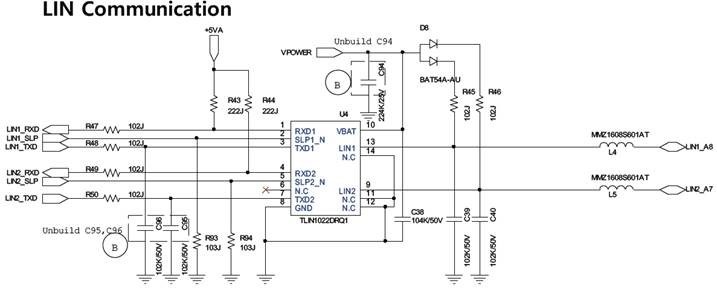

    Is there any way to improve H/W?
    Please check if there is a way to reduce break delimiter time in the schematic.
  • Cho,
    Thank you for the LIN waveform, there doesn't look to be anything wrong from a signal integrity standpoint. I can't tell the value of the capacitors on the LIN pins, but again, I don't see any issue with the LIN waveform. Once we get screenshots of TXD, LIN, and RXD this will help to understand. We need to make sure that the TXD bit width is wide enough to support the break delimiter as it gets translated into the LIN signal.
