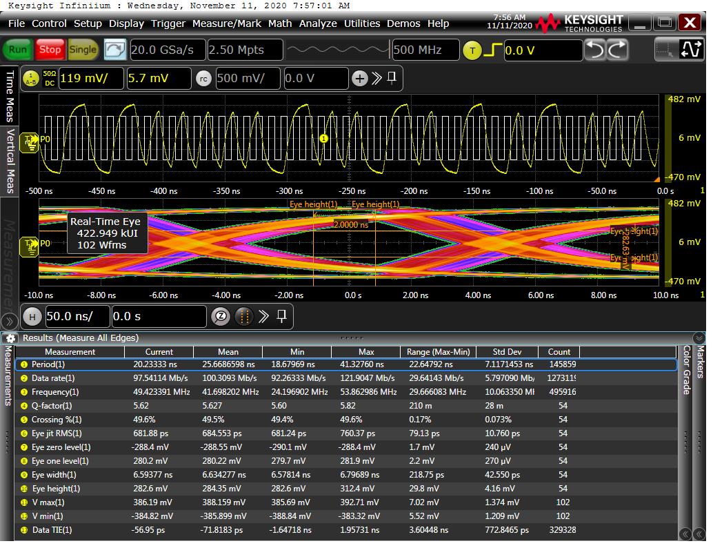

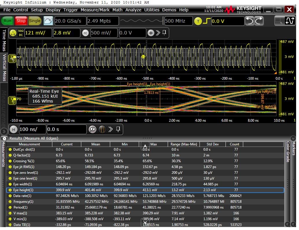

We are currently validating the Vod-bc requirement of the back channel.
We have tested under two different conditions.
  1. Oscillator without spread spectrum --> Pass the Vod-bc requirement from your datasheet Vod-bc = 400mV (spec: 380mV to 520mV). See osc caputres below.
  2. Oscillator with spread spectrum --> Fails the the Vod-bc requirement from your datasheet Vod-bc = 280mV (spec: 380mV to 520mV). See osc caputres below.
We have been testing in the past without SS, but to have a pass in EMCs we need to use a SS clock. In our case we are using +-0.1% deviation. In the past a former colleague was already in touch with you to define the SS required in this post --> e2e.ti.com/.../870913
Is it possible to relax the Vod-bc spec if SS is used?
Thx for your support,
Vicent Climent.
WITHOUT SS
WITH SS

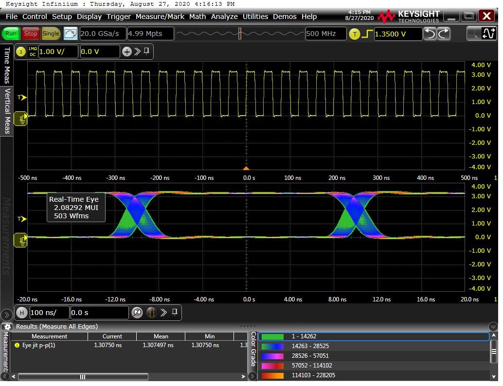

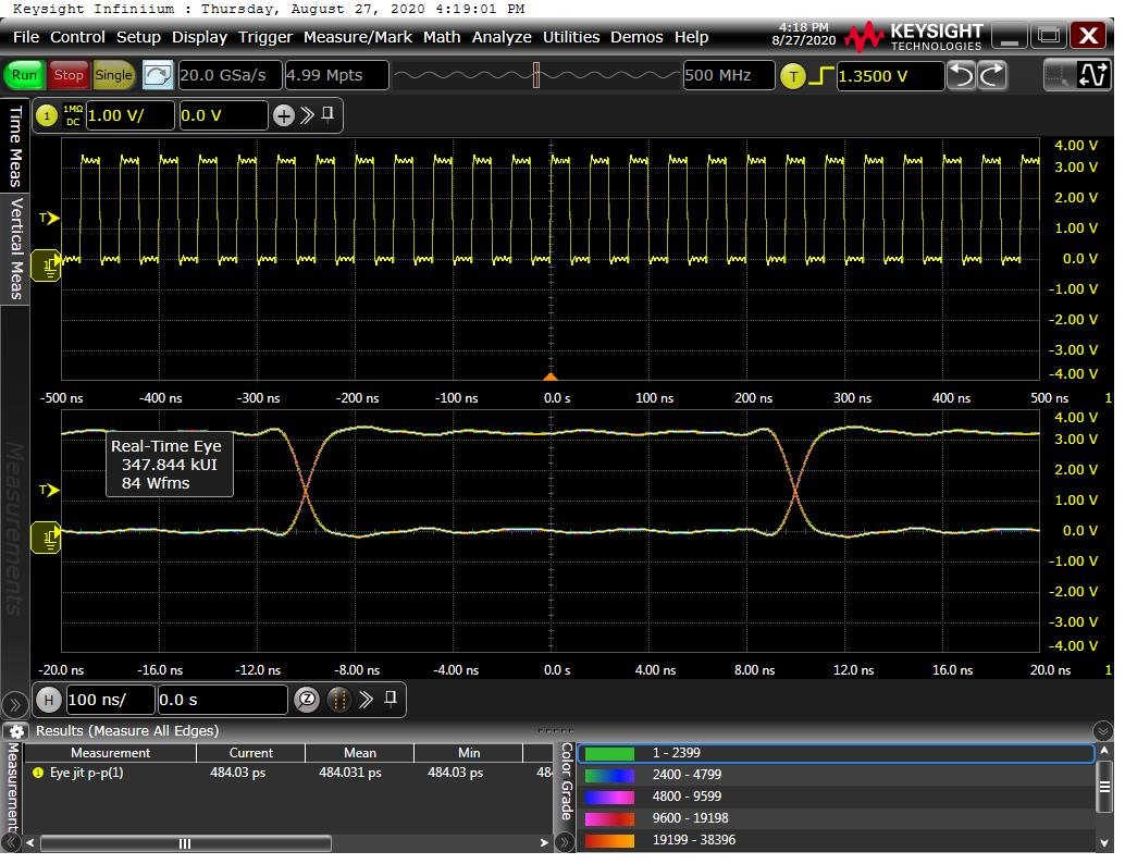

    In terms of Vhigh and Vlow the behavior is very similar. When checking the jitter, the one with the SSC is much higher as expected. See pics below.
    Yes, when using SSC we are getting lock. The ECU is completely functional with and without SS activated, but we are not fulfilling the Vod requirement in this case.
    Oscillator without SS:
    Oscillator with SS:
  • Hi Vicent,
    Both scopeshots show the correct amplitude. Are you referring to the back channel differential output? Can you measure it on the scope?
    Jiashow
  • Hello Jiashow,
    Exactly, the Vod-bc problem I am referring is on the back channel differential output when we are using SSC. The osc captures were shared on my message from November 12. Find it attached in this msg too.
    What we are trying to validate is the following parameter of the datasheet:
    So we are correlating Vod-bc with our eye height measurement. Maybe this correlation is wrong, and we should just simply measure Vmax in single ended.
    Below the pics of Vod-bc:
    VOD-BC WITHOUT SS
    VOD-BC WITH SS
  • Hi Vicent,
    I see your point regarding the eye height. We don't have characterization data on this with SSC, so it's difficult for us judge whether eye height can affect the link performance.
    Since you're seeing no issues right now, what I would suggest is instead of looking at the eye height, run the margin analysis program to check the margin with SSC:
    If your margin is good, then the link should be good.
