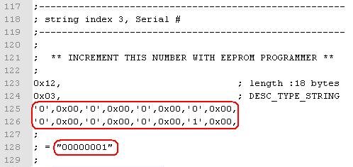

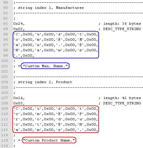

  • Hello Paddu,
                    You just have to open the .cfg file that you want to use with a text editor software (notepad, note pad++)  for this case I recommend you the  VCP-3410-FW_Download-EEPROM_serialized.cfg file and modify the parameter that you want to change:
    ·         VID/ PID
    ·         Manufacturer and Product Name strings.
    ·         Serialization (assuming you are enabling serialization, which is TI recommendation).
    b)       Once the CFG file has been customized with your desired information, create your EEPROM file using the header generator utility per the “Header Gen for VCP Apps User's Guide.txt” document.
    ·         To generate the BIN file use the "gobin VCP-3410-FW_Download-EEPROM_serialized" command. (Here you should first open a command prompt window, and go to the proper directory where the Header Gen utility is located).
