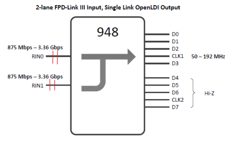

Dear team,
My customer wants to reserve two designs on one display PCBA to connect two different hosts. One host is a USB interface, and the other is an HSD interface. So there are two LVDS INs, but they do not exist at the same time. That means they choose 2-lane input, but every time there is only one lane(RIN0 or RIN1) works, and single link OpenLDI output. Is this feasible?
