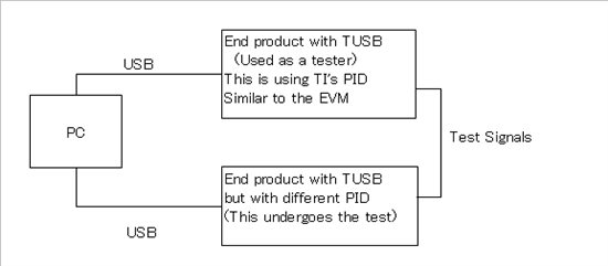

Our customer is using TUSB3410 in their custom board
and in their mass production test process they are connecting two
TUSB3410 board one as a jig to test the target boards and the other the target TUSB3410.
Both have different descriptors.
And they are removing the target devices with the below sequence.
1.Close the Com port
2. Remove D+,D- after 200ms
3. Remove VBUS(external power supply) after 50msec
Around once in 50 time there are having the trouble with
the com port, the device manager shows yellow mark on the TUSB3410 com port
and they cannot continue with the next device because the COM port
doesn't open untill they remove the USB cable of the "TUSB3410 board used as a jig to test".
Is there any reason for the yellow mark on the TUSB3410 com port.
This yellow mark is occurs when they remove one TUSB and another TUSB remains
connected to the PC.

    This situation has occured in the mass production site and
    below the block diagram is their present test process.
    And as mentioned above they are using switches and delay in their test setup to create a closing sequence as below .
    1. Close the Com port
    They are using the latest version of the drivers provided from TI
    and the firmware is Standard one.
    They are using HP compaq PC with Windows XP SP3.
    I think you can reproduce this by plugging and unplugging (around 50 times)
    two TUSB enbled target bords(TI's EVM)
    one with standard PID and the other with a different PID.
    Today morning when I tried with two TUSB boards with different PIDS,
    there was a situation when I Pluggled/Unplugged both simultaneously my PC's
    USB port went wrong and I had to restart the PC.
    For time lets forget about this issue
    I would like to know whether the "yellow mark"  issue could be solved
    if our customer uses different PID even with the end product (with TUSB) used as a tester
    shown in the above diagram.
