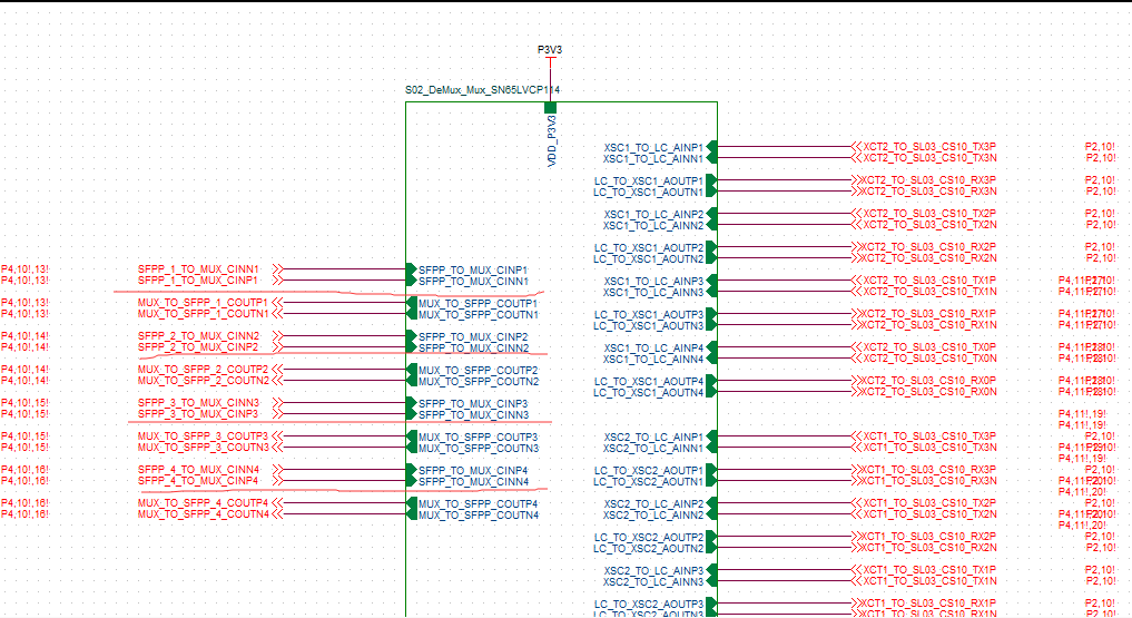

hello
i have switched the P/N of input,but didn't switch the output,is that OK?

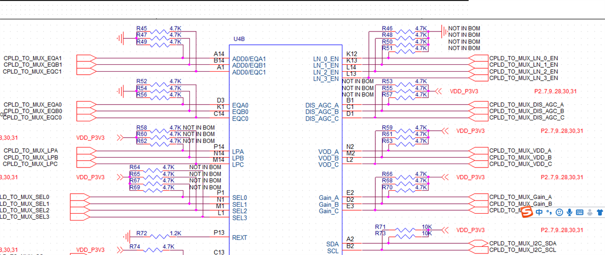

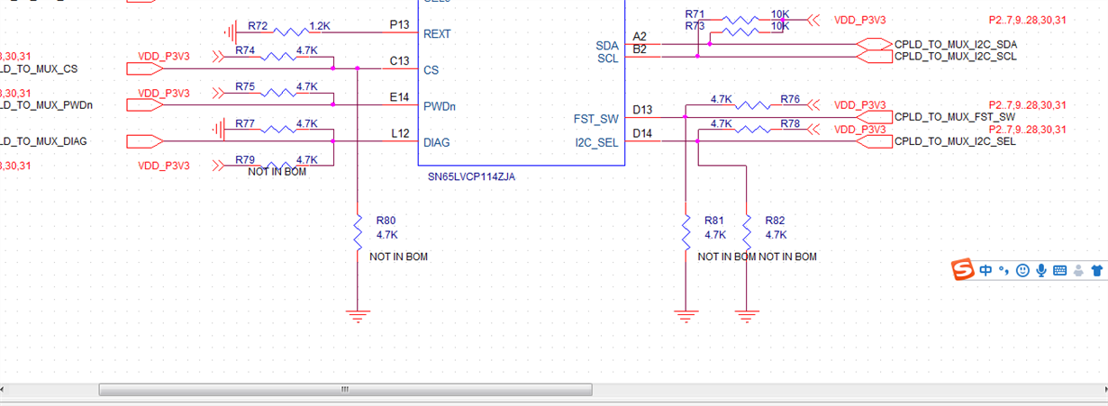

for the configuration,i reserved I2C interface and GPIO,choose one according to the need,if there is pull up resistor in chip,i have added a pull down resistor on the schematic,but don't install it on the PCB.
please check it for me ,thanks.
Greetings,
This is application or protocol dependent. But normally if you switch input polarity, you should also switch output as well.
If you have already done your pcb and input and output polarity are reversed, then through the register you can change output polarity - if needed.
