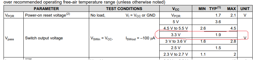

Below information shows Vpass  = 1.9V when Vcc = 3.3V

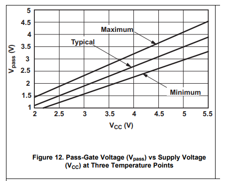

But the Figure 12 shows Vpass = 25V when Vcc = 3.3V in typical.
Which information is correct?
Anyway, Can PCA9544A meet above condition which 3.3V Master and 1.8V Slave?

  • Nagata-san,
    I would recommend using TCA9544A and setting the Vcc to 1.8V instead. Doing this would resolve the issue.
    Otherwise, using figure 12 from what you referenced, you would need to set Vcc of PCA9544A to about 2.5V or lower (2.3V lowest Vcc recommended on this device) to ensure it would work for the maximum case (this is the worst case).

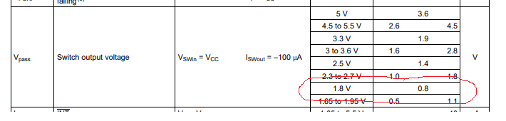

  • Bobby -san,
    Are your suggestion :
    TCA9544A
    -Master :3.3V
    -Slave :1.8V
    - VCC:1.8V
    I'm confusing because TCA9544A datasheet shows below. Typical Vpass support the 0.8V when Vcc = 1.8V. Is it possible to support 1.8V slave when Vcc=1.8V?
    Nagata.

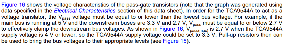

  • The VPass spec in the datasheet shows the voltage at 100uA and provides the Vth value of the pass FET under those conditions. The difference for what you circled is 1.8V-0.8V = 1.2V =Vth of pass FET
    Using figure 16 in the datasheet:
    This means that if the lowest voltage on the I2C bus is 1.8V (your V pass in the graph) then Vcc MUST be about 2.6V or less in order to support 1.8V
    This means you can use Vcc = 1.8V as a result. Using Vcc= 1.8V means you can support up to 5.5V on the secondary channels.
    This section in the datasheet also walks through an example of this:
