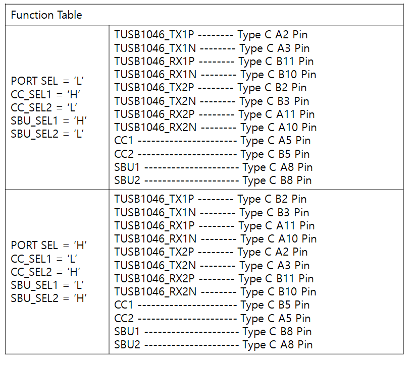

Hello.
I'm making USB Type C Video Signal Generator.
The circuits are designed with TUSB1046 and TPS65982.
There is one thing I want to test.
In order to flip, USB Type C Cable needs to be attached after removing and changing the cable direction, but I want to implement it without removing the cable.
To do so, we would like to construct a circuit as shown in the attachment, and would like to hear your opinion on whether it is correct to configure this way.
The attached photo does not include circuits TUSB1046 and TPS65982.
