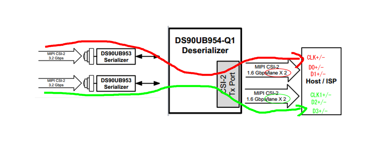

In the case, have different two cameras, SER with DS90UB953,an DES by a unit with DS90UB954, sent to a SOC。
My question is :
CAN DS90UB954,output "two" "2-lane" MPI-CSI, for two camera data independent?
as the picture below:

This is not possible using the 954. You can output both cameras into one port only. You can use the second CSI-2 port but it will be an replication of the first CSI-2 port.
Nevertheless, in the 954 you can assign different virtual channel ID for each camera data, and then your SoC will seperate the two data streams from each other.
