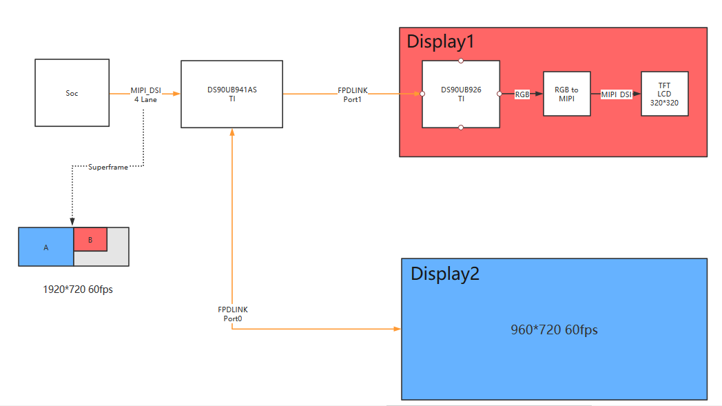

Hi expert,
I used the following block diagram design, but the display1 is abnormal(The correct display should be a yellow circle). Please help analyze the reason.Thanks.
  • block diagram
  • Superframe
  • display1
  • 941as register
Register Display - ALP Nano 1 - DS90UB941AS, Connector 1
