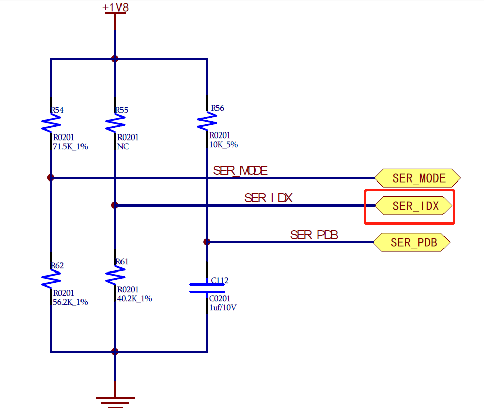

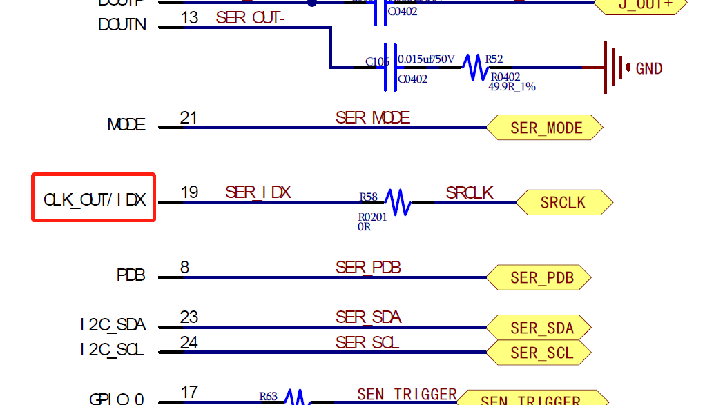

Customer now use camera sensor AR0233 +953.
And the osc is in 953 side, now customer reuse this PIN (CLK_OUT) to provide clk to sensor,
Is it other things need to configure?

Hello Amelie,
this looks good. Additionally you will need to set reg 0x06 and 0x07 to get the desired CLKOUT value.
If you use the dafault, you will get 1:1 with the REFCLK. For wxample if REFCLK=25MHz, you will get at CLKOUT = 25MHz.
