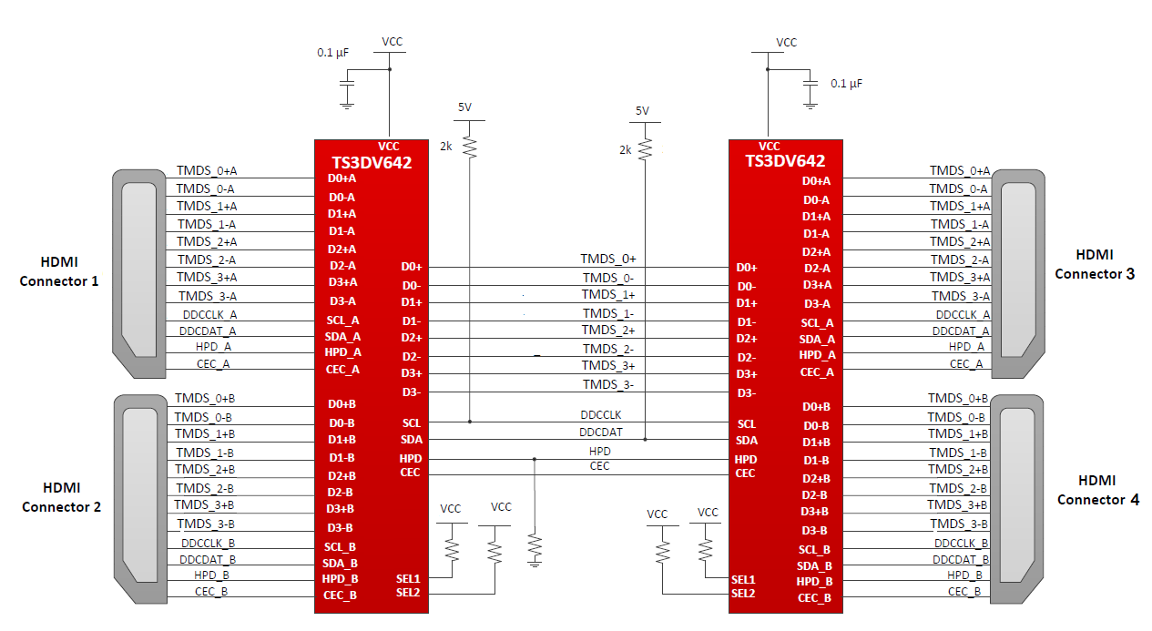

Regarding to HDMI2.0 (4k60p) cross point SW with TS3DV642,my customer is asking a question.
Their idea is that two TS3DV642 are used as following.
(Question)
Can it be supported with two devices? Is there any concern or problem?
I have some concern of PCB layout (impedance/eye pattern) or crosstalk.
I think they need to fully verify about them.
Could you please give any advice or comment?
