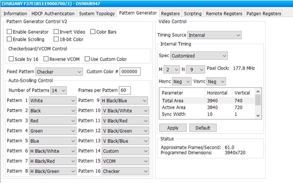

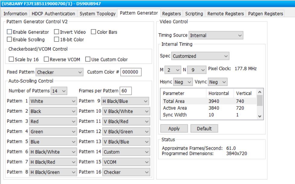

Team,
Could UH947-Q1 run below condition?
Roy
Hi Roy,
No the 947 does not support pclks higher than 170 MHz.
Michael W.
