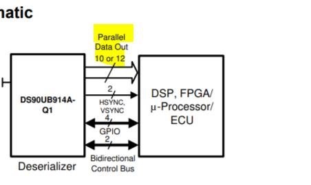

Hi Sir,
could you help confirm as below
- TI-DS90UB914 can output 8Bit parallel data with Hsync/Vsynd embedded?
- How to set DS90UB914 output format?
- What is the suggestion for this case?

Hi Tommy,
8-bit with embdded hsync/vsync isn't supported.
