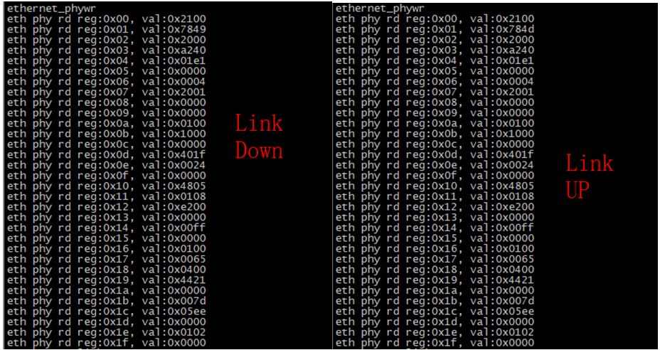

DP83822 is transformerless configuration and connected to LAN9500, both of DP83822 and LAN9500 are configured to fixed 100Mbps and auto-crossover.
However, it's found that DP83822 shows to be link up and link down continuously, while LAN9500 is always link up.

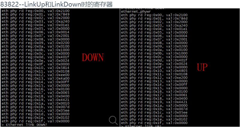

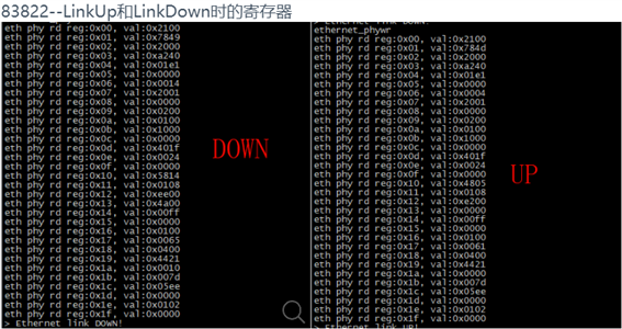

When linked up, the 0x01 registers value is 0x4805 which tells that the signal detect is 0 and false carrier sense latch is 1, then it will become to link down. The registers value when the link is up and down is as below:

  • Hi Adrian Kam,
    LAN9500 is connected directly with DP83822 with 0.1uF capacitor, and register 0x0404 is set to 0x0024, the issue still exists,
    When linked up, the 0x0010 registers value is 0x4805 which tells that the signal detect is 0 and false carrier sense latch is 1, then it will become to link down.
    Also, the 0x0012 register is 0xe200.
