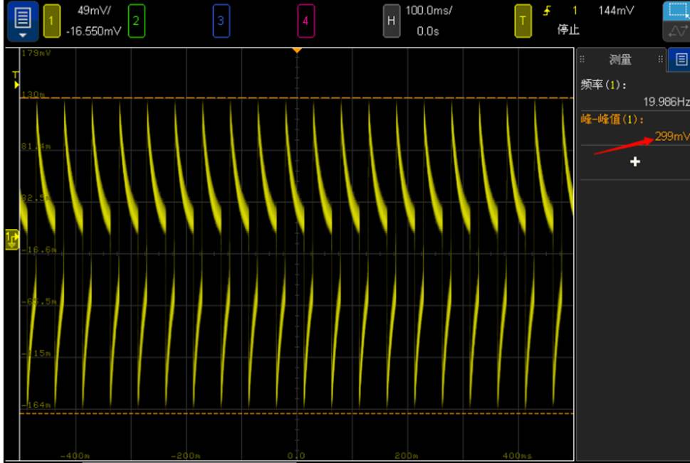

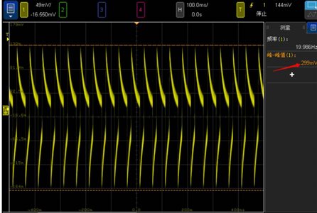

It's found that there is 20Hz 300mV ripple on POC in 953 side, the frequency is the same as the frame rate, but the ripple will disappear when frame rate synchronization is removed.

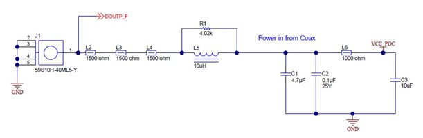

  • Hello Hao,
    ~300mVpp at the input to the switcher before the PoC network is not necessarily an unreasonable measurement since the high frequency content will get filtered out before reaching the sensitive node which is at the input to the serializer AC coupling cap after the PoC network as long as the PoC network itself is designed well. Here are a couple recommendations:
    - Measure the slew rate of these noise pulses at 20Hz. Our general recommendation is that they should have a slew rate of > 100us/V. If the slew rate is faster than this, then add more decoupling cap at the input to the regulator to slow down the voltage spike slew rate
    - Please send your PoC network for us to review including the specific passive components used
    Casey

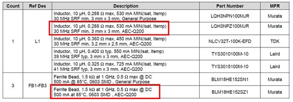

  • Hi Casey,
    The pictures below are the schematic and the inductor part number, thanks!
    Best Regards!
    Hao
  • Hi Hao,
    Did you measure the slew rate?
    Sally
