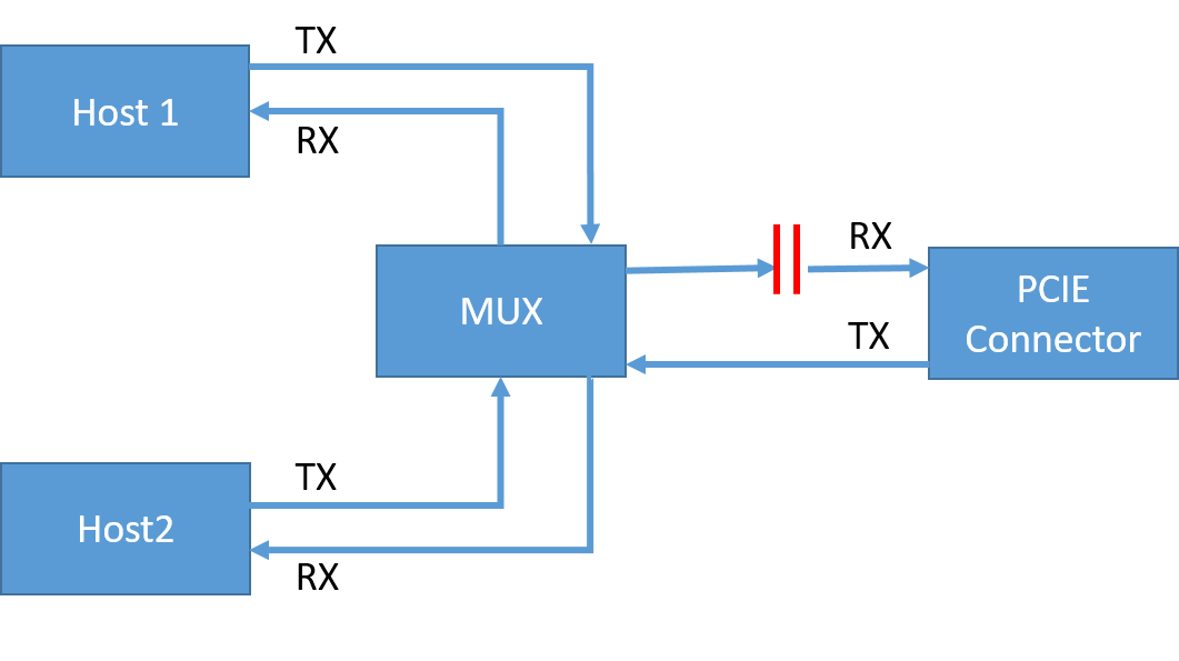

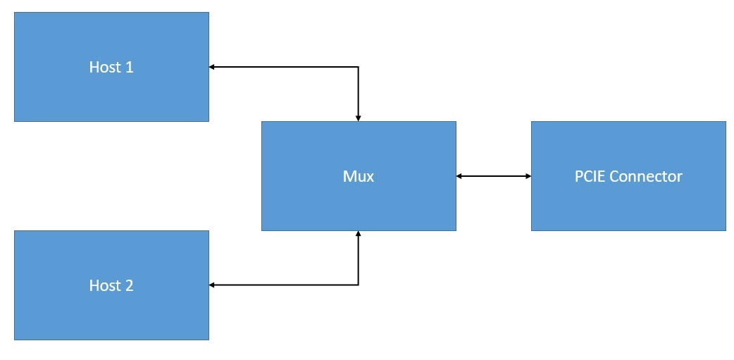

Part Number: TMUXHS4212
Hi

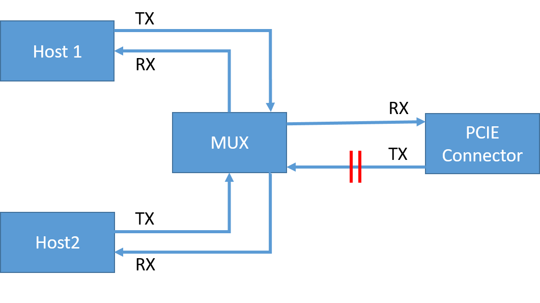

We want to use TMUXHS4212 for PCIe Gen4,
DATA SHEET description AC coupling have 3 types placement.
If use for PCIe Gen4, Which one placemetn recommand for PCIe Gen4?
Hi
Prefer Cap on connector side if common mode voltage large than 2v form the other side
