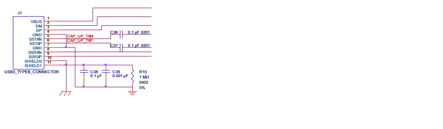

Met hard issue here. After safety ground of the equipment is connected, the USB interface cannot be recognized by other devices. When the safety ground is disconnected, the USB can be recognized again.
No doubt that the safety ground introduces some noise, something that influence the USB device.
Have you met similar issue before? Do you have any solution to solve the issue? Any TI devices can handle such situation?
