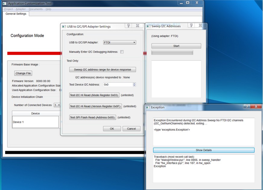

I tried to connect the customization application tool with my TPS65988EVM via FTDI,
When I execute "sweep I2C Address range for device response", always fail and pop up the message below:

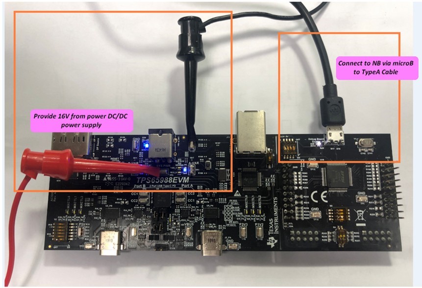

And I have confirm the driver install of my computer is success already:
Below I also attach my EVB setting for your reference,
1. Could you get me a hint why I always connect EVB with NB fail via FTDI?
2. Does this EVB support TIVA interface also? How to setup it?

    Have you tried using a different USB cable and also the other USB ports on your notebook? Sometimes a COM port could be interfering with the Config Tool. You could also double check to see if you have the latest drivers.
    Alternatively, yes you could use either a TIVA board or an Aardvark programmer as well. You would simply need to just connect the ground and I2C pins to the same port that the Flash is connected to.

  • Hi Hari,
    Thanks for your prompt reply.
    This issue will be solved when connect with the other notebook.
