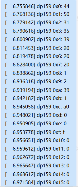

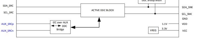

our customer is using SNX5DP159(48pin) to achieve DP to HDMI. now AUX_SRCP/AUX_SRCN input has signal while SCL_SNK/SDA_SNK has no signal output. could you kindly help on this?
The debugging situation is as follows:
1. Hardware: input via AUX
2. Software: Initialize DP159 through I2C:
    (void)dp159_write(client, 0x09, 0x02);
    (void)dp159_write(client, 0x0B, 0x01);
    (void)dp159_write(client, 0x0C, 0xA0);
    (void)dp159_write(client, 0x0D, 0x00);
    (void)dp159_write(client, 0x0A, 0x3d);
3. Register: read register value
