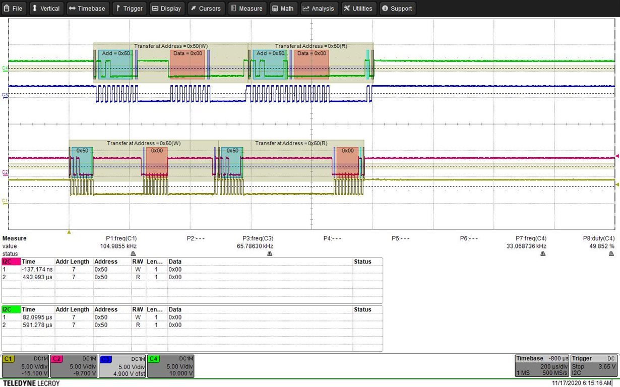

A customer wants to confirm if the line speed of the I2C can be changed. Please refer to the screenshot below.
CH1 & CH2 are input to DS90UB927QSQ and CH3 & CH4 are output from DS90UB928Q-Q1 to a slave device. The Line Rate was changed from 100kHx to 50kHz, but the I2C line rate from the DS90UB928Q-Q1 to Slave remained at 65kHz
He cannot identify any registers in the devices that allow him to do this and he would like to understand why the line rate appears to be fixed at 65kHz from the DS90UB928Q-Q1 to the Slave. Also changing the input frequency to DS90UB927QSQ PCLK also has no effect. Is it fixed from the 10Mbps back channel rate?
