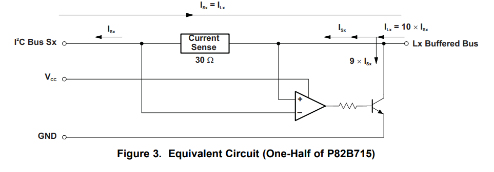

    P82B715 instead operates as a current amplifies, allowing the original signal driver to sink a small portion of the current needed to drive the high-capacitance bus or cable low. Because the original signal driver is physically connected to the extended bus, no isolation is possible and the signal driver is still responsible for sinking a portion of the extended bus current.
    P82B715:
    I hope this helps your understanding of these two devices. Let me know if you have any other questions.
