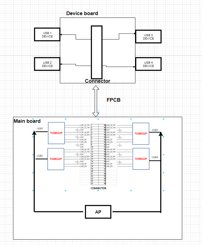

Hi, I am going to use 4 USB 3.0 Device.
From the Main board's AP(application processor), there will be four USB 3.0 lines will go through TUSB522p for each USB.
Below is simple block diagram.
Main board - TUSB522P - Connector - FPCB - Device Board - USB Device.
I wonder will this possible?

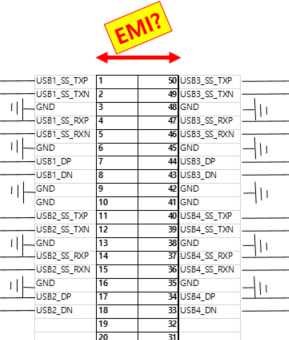

Because USB 3.0 is very sensitive line, I am worried about using this kind of connector.
Will USB 3.0 line on the each opposite side can make any EMI and make interference?
Or will it be okay when using TUSB522p? Can TUSB522p overcome this emi?
