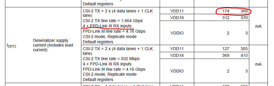

Hi experts,
960 datasheet shows the 1.1 V rail supply current data under 4*RX inputs condition.Do you have that data when there's only 2*RX inputs? Thanks.

Hello Arie,
we do not have the current consumption specified for only 2 FPD-Link inputs for the 960.
Nevertheless, this should be very similar to the 954 power consumption.
